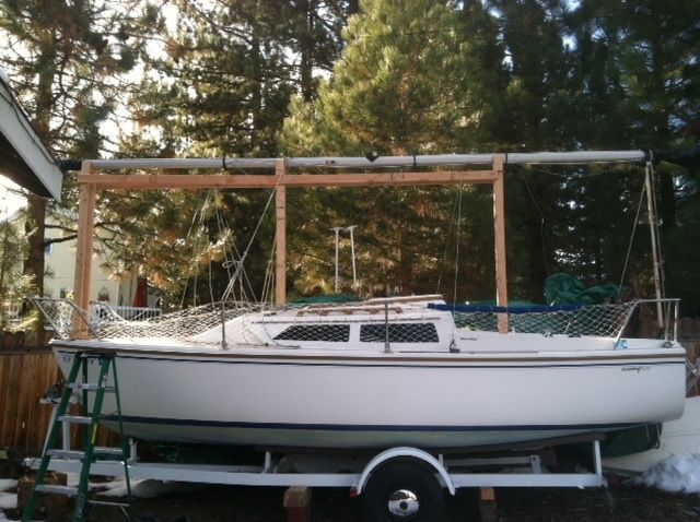

Response Posted - 10/31/2013 :  21:05:25  Show Profile
I use the mast down as a ridge beam as well. Use a few lines front and rear to the dock line cleats which holds mast steady and tarp bungees to the trailer. We get feet of snow and it just slides right off. Takes a short time to throw up. These pictures were taken in the fall before last winter. I will be covering my 250 the same way.
