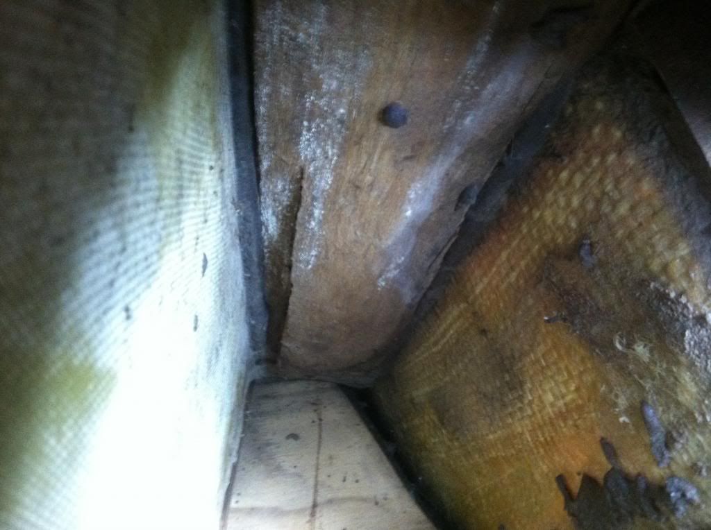

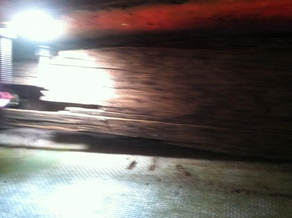

Response Posted - 03/15/2014 :  13:58:38  Show Profile
This is the image looking up from the quarter berth. the first picture is the very front panel then the next access panel aft.
[URL=http://s1319.photobucket.com/user/stang9150/media/IMG_0638_zpsa7f4c655.jpg.html][/URL]
[URL=http://s1319.photobucket.com/user/stang9150/media/IMG_0641_zps293e8f10.jpg.html][/URL]

Response Posted - 03/18/2014 :  14:59:21  Show Profile
Well after looking more at this issue I don't think I can use any type of screws to fix this problem, I think the screws would poke right through the bottom of the bench it appears to be pretty thin.I think my best bet would be to mount some pieces of wood up there with 5200 and then glass over it with fiberglass mat.What do you guys think?
Response Posted - 03/18/2014 :  17:32:54  Show Profile
<blockquote id="quote"><font size="1" face="Verdana, Arial, Helvetica" id="quote">quote:<hr height="1" noshade id="quote"><i>Originally posted by stang9150</i>
<br />Well after looking more at this issue I don't think I can use any type of screws to fix this problem, I think the screws would poke right through the bottom of the bench it appears to be pretty thin.I think my best bet would be to mount some pieces of wood up there with 5200 and then glass over it with fiberglass mat.What do you guys think?
Just pump it full of epoxy and don't worry about it.

Response Posted - 03/20/2014 :  10:06:05  Show Profile
I'd use West System G/flex. It's good on wood and has some give when it's set up. I'd use it for the splint--not 5200--because it isn't just a surface adhesive. It penetrates the wood.
I suspect I'd also use a syringe to get the epoxy up into the break before splinting. Then, if possible, I'd brace the broken area upward until the epoxy sets. Then I'd apply the splint. Glossing over that couldn't hurt, but might not make that much difference.
