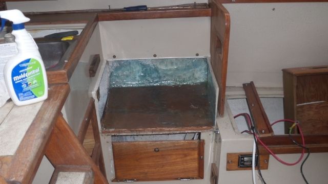

I pulled a gimbal mount propane oven that I never used and am building up the "drip tray" to carry the load of a mini-fridge. I'm stuck deciding if I should foam up the icebox and permanently panel it shut, or leave access open to plumbing and air circulation. If I do panel up, can I get a recommendations on polyurethane foams that will not leave lots moisture collecting gaps I only found after pulling the previous yellow foam?

Good call on the heat use. I don't understand? I have a potty to port and no sink, and a closet rack to starboard. Did you lose a bed space in the v-berth?
I'm pretty happy with the combined resin job. West Systems provides piece of cake bonding solutions, but is expensive. So, while the epoxy was still tacky, I saved a few bucks laying the glass with polyester resin, hoping the two would bond. After jumping up and down on the board then kicking it from below, I'm ready for a light sand and lots of Formula 27. I used to baby-butt smooth the nibs, but injuries prevent me from using power sanders on fiberglass.
With the strength I need present, I can move forward without aft panel for now.
