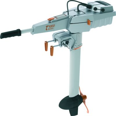

I have a Torqeedo 1003L in my Defender Cart. I really don't want a 95 pound motor on my 22' boat and I am done pulling starter ropes so If I don't go electric start at 90 odd pounds then I need to try something different. The 1003 has an integrated Lion battery so there is no external batteries like with the larger Torqeedos. It seems to have some design issues though, the tiller does not articulate like normal OBs and the prop diameter is large so I need to check rudder clearance.
Does anyone have experience with them recently?

If you get the 1003L check the amps per hour usage rates and compare to the amp/hour rating of the Lion battery to see how many hours of "motoring" you'll be able to get.
I went with the 2.0 L Cruise. Yes, I have to use two 12 VDC batteries to get the 24 VDC that the motor needs. On Snickerdoodle (C25), there is enough room in the fuel locker for both of the batteries. I went with 110 amp/hour Group 27 deep cycle batteries and have been very pleased with the performance. The only problem I've had is if I want to go from Bayview (where my marina is) to Sandpoint (some 30+ miles away). If there's no wind at all, and I motor all the way, I have to keep the boatspeed at about 3.5 kts to make it all the way on one charge.
I do have my two 12 VDC house batteries as a backup - - and have used them as backup once when I ran out of charge on the primary bank.

But looking at the specs, it appears the 1003 on a full charge might take you the length of Cheney and halfway back at 3.4 kts (~4 mph). So, is that enough? Do you have a charging source? Running on 29.6 VDC, there might not be a practical option for backup except their own spare battery--an accessory.
According to the drawing on the tech specs page, you can use the tiller at up to 30 degrees tilt. Enough? There's an accessory tiller extension.
For those worried about shaft length, it has two choices--the equivalents of L and XL on gas outboards. On a 22' on an inland lake, the standard length might be fine.

I use mine mostly for the 100yds in/out of the marina, and it's been outstanding for the purpose. At full power (on a C25) the Torqueedo can push the boat up to almost 4knots / 2 miles, so I would imagine it would be slightly better on a C22 (if ever needed). At a 2knot cruise, I can run for a couple hours, but the lake isn't big enough for that to matter. I did have to get over "range anxiety", but experience has made me more comfortable with the limitations. I haven't hooked up a back-up connection, but might do that to add flexibility. And, no, the prop can't be used to recharge the battery -- Torqueedo does not recommend leaving the prop down when not under power (free-wheeling will damage something).
With its light weight the 1003 is easy to handle on and off the boat when I remove it. I did have to modify the transom mount so that the tiller could swing past the stern by adding aluminum "extensions" between the mount and the bracket -- with that mod, the motor maneuvers easily.
The motor isn't cheap, but it is 100% reliable and basically maintenance free, so I spend more time sailing! Pay-off on the investment comes in the form of enjoyment. There is also the fringe benefit of no oil or gas onboard, although I haven't decided yet what to put into the dumpster (I never did like having gas fumes down there).
