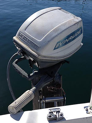

I've always wanted the smallest, lightest engine I could find for my little lake. and I've been using a 4 hp for some time now, as well as my 6 hp sailmaster that came with the boat. They have both died. they crank but have no power, I'm guessing the rings have finally worn out.
Anyhoo.. I'm ready for a 4 stroke. but worried about the storied of not cranking... the clogged carb jets stories...

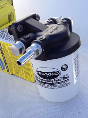

So I went out and bought a new 3 gallon tank, and the new vent inline contraption, and new line and a fuel filter.
The tank and filter will fit into the fuel locker. I'll add a strap or two to hold the tank down.

Are you sure you need a water separator? One of the nice things about 4 cycle is that you can just put the gas in your car every couple of months and start over with fresh fuel. So you use it up before there's enough water to separate. With that, a little fuel stabilizer, and disconnecting/closing the vent on the fuel tank between uses, and I've never had a fuel problem. I also burn the gas out of the carb after every use.

<< Are you sure you need a water separator? >>
not so much a water issue as simply a good filter to keep any debris out of the carb jets. I like the big filter and I've used this product on a bigger boat for years. The dealers always have this size filter, when I went to West Marine and looked at the smaller fuel filters they were always more expensive and changed inventory every time I went in.
This fuel filter for big boat engines ( I think ) will always be in stock.
Response Posted - 03/09/2015 :  05:34:38  Show Profile
Originally posted by redeye
...a good filter to keep any debris out of the carb jets...
My Honda has a filter for this inside the engine housing. I replace it every year. My other 50 hp outboard has a metal screen filter that's integral to the fuel pump. I open it up and clean it every year.
You might want to check and make sure your outboard does not already have something built-in, if for no other reason than to see if it needs periodic maintenance.
