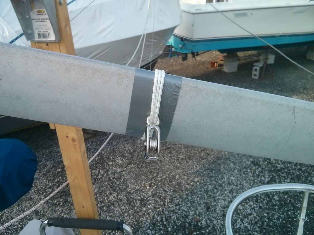

I bought two cheap clothesline pulleys from Home Depot and lashed them with 1/8" polyester line from West Marine. The zip ties would have probably worked, but I thought a few lashes with line would be less likely to loosen and/or slide along the spreader. I added a little duct tape to provide even more friction, and to prevent any galvanic corrosion between the pulley and the aluminum spreader.
The mast went up this evening, so I'm not changing it.
How do you guys recommend attaching a burgee to the halyard?
Edited by - TakeFive on 04/21/2015 19:52:44
