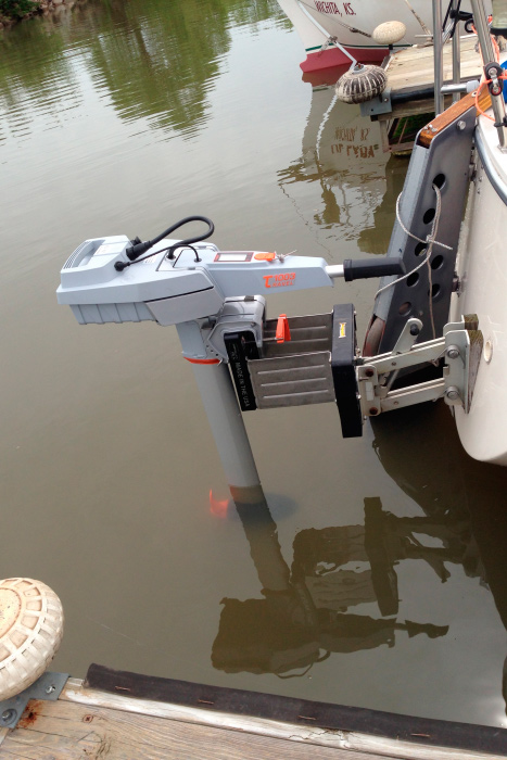

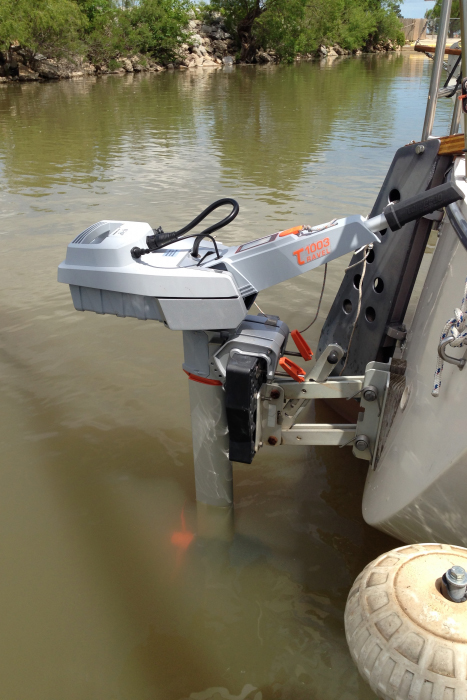

FINALLY we had a dry day to launch and I got to try my new Torqeedo. It does not fit well. They are designed with a tender in mind, intended for a transom hung position, not a motor mount position. By being on a motor mount the mechanism of the mount interferes with tilting while the battery and tiller are in place. The tiller is too long when in the run position. My fix was to move the motor out on an additional rigid mount.

Hi Frank,
I had extended my outboard bracket previously to work with the 8hp Mercury that preceded the Torqeedo. The Cruise 2.0 is a bit less bulky than what you have... but still needed the extension.
