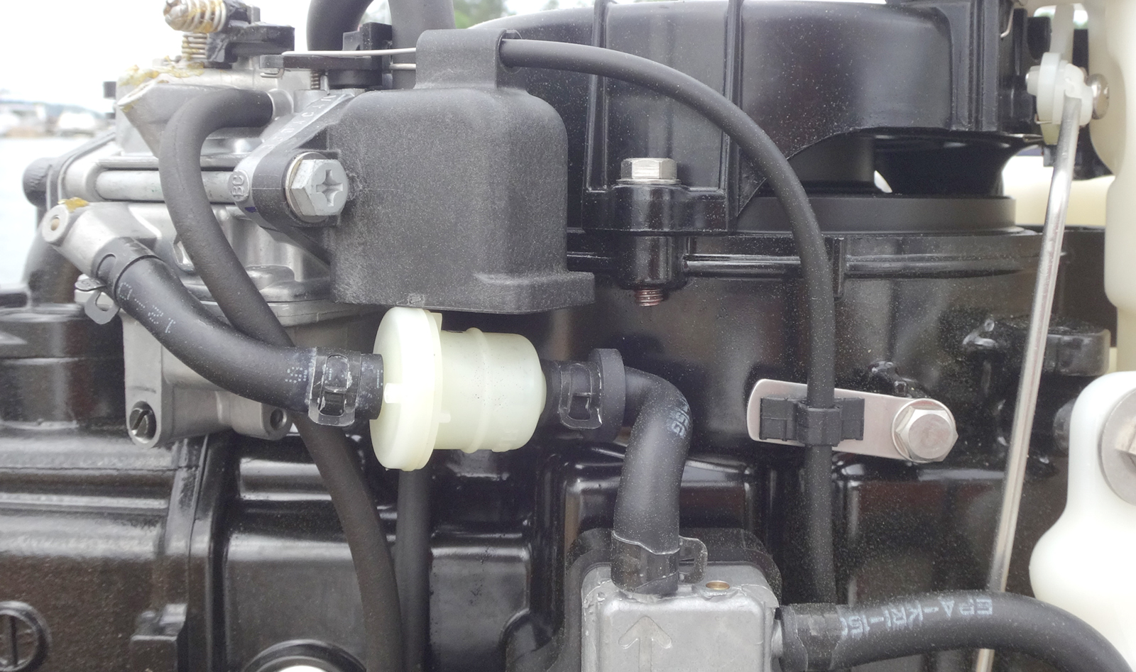

 2012 Evinrude Fuel Line
Initially Posted - 06/03/2015 :  17:27:47  Show Profile
http://rayswords.com/temp/150603_fuel_line.jpg
http://rayswords.com/temp/150603_fuel_line_b.jpg
Is it just me or does that look like a problem waiting to happen...
Really.. they expect a turn in the line like that to hold up over time.. I would think that would pinch shut in no time...
and the plastic fuel filter?
Anyhoo.. I'm gonna look for some more fuel line to have onboard.
Response Posted - 06/03/2015 :  17:51:20  Show Profile
Why not just remove the straight line on the left and cut a piece off. By shortening the left side it will allow the hose on the right to be rotated around to the left which will straighten out the kink.

Response Posted - 06/04/2015 :  04:36:49  Show Profile
<< shortening the left side it will allow the hose on the right to be rotated around to the left which will straighten out the kink. >>
It is pushed in like that cause it is the only way the fuel filter will fit inside the cowling. The cheep plastic fuel filter looks like a hazard to me.
I expect to add another line without the fuel filter as I've got a big fuel filter on the incoming line just after the tank.
Response Posted - 06/04/2015 :  05:11:32  Show Profile
Ray, It looks like the fuel line is a pre-formed line from the photo. Similar to a radiator hose. If you were to try and substitute it with generic straight fuel line it would probably have a kink in it. The filter looks very similar to what is on my Honda. I don't know if I would remove it, It is another line of defense.

Response Posted - 06/04/2015 :  05:48:35  Show Profile

<< Ray, It looks like the fuel line is a pre-formed line from the photo >>
No, not pre formed.. you can pop it out of the kink. It's just rubber fuel hose and not an especially well made hose. I just bought a bunch of Evinrude OEM fuel hose at about $5 a foot and its a much thicker walled line.
This is not anything I'd consider immient, just something the dealer would charge you $50 to replace in a coupla years after the engine dies on you..
Anyhoo.. It could be a backflow checkvalve for all I know, but it is something I'm gonna check out.
