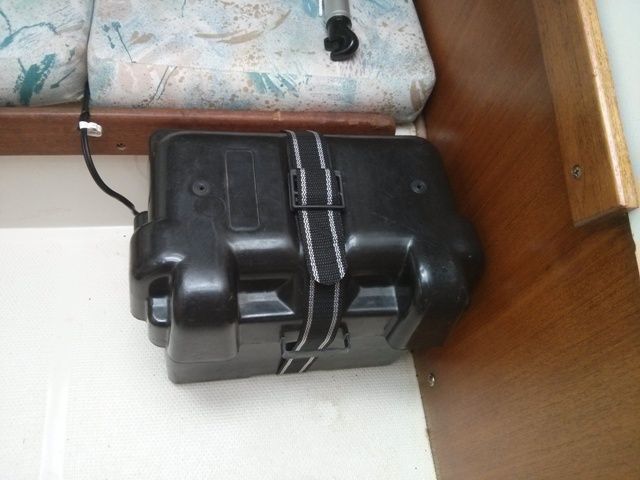

Response Posted - 06/29/2015 :  19:10:51  Show Profile
Here are some pic that might help you.
