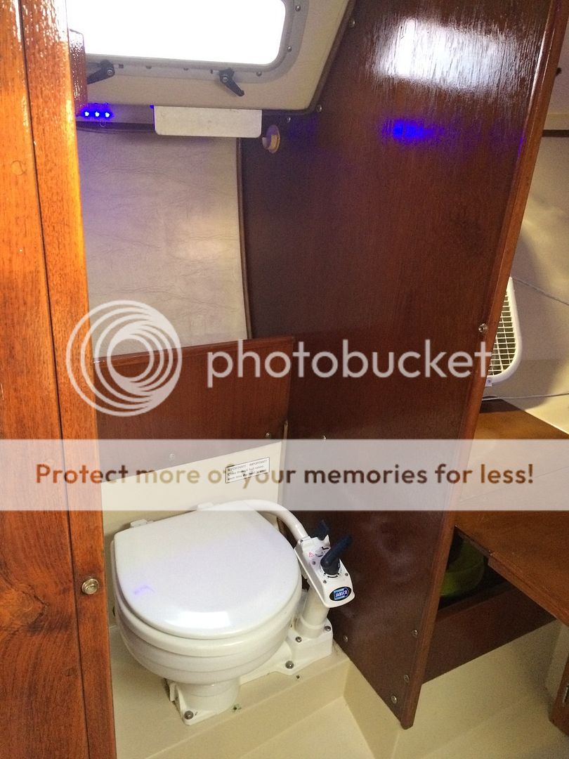

I used Cetol light on the interior and after one coat didn't like the darkness I was getting so just applied numerous coats of gloss after. Overall I'm happy with it and I also like the idea that it will be easier to keep clean.
Also the gloss on the interior seems to add depth and make the cabin feel larger.
