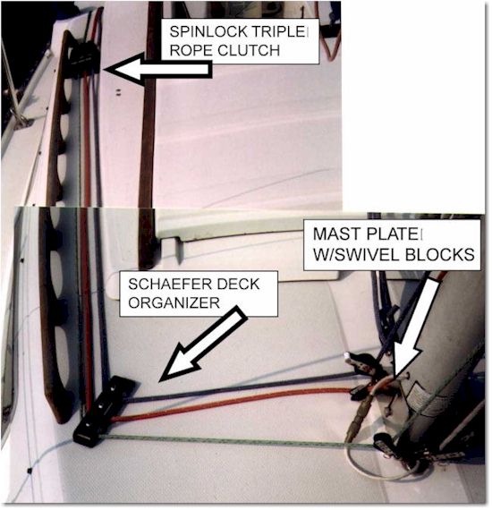

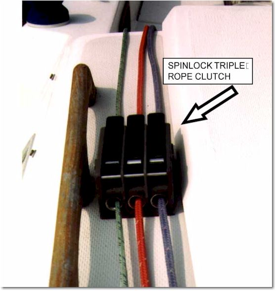

<font face="Comic Sans MS"><font size="3"><font color="navy">Here is a very old pasted up photo of Peregrine's triple clutches.
The triple organizers are way out by the hand rails keeping them away from the pop top and lined up with the clutches that also clear the pop top.
Peregrine has triples port and starboard.
The blocks are just a hodge podge of blocks I had around it would be nice replace them with new ones.
