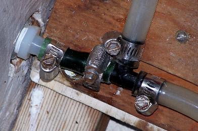

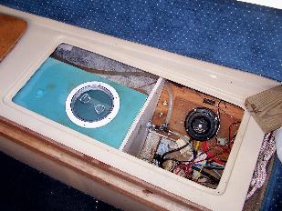

I had a leak in my water tank on my 1978 Catalina 25. I was able to repair it by cutting in an inspection port on top of the tank which enabled me to reach in and replace the exit fitting from the tank. Problem solved, See photos.

Harold
I too have a 78 Catlina with that same tank configeration. How did you determine where your leak was?
I was about ready to buy a new tank and go through what would be need to take the old one out and put new one in...but your method maybe what is in order and would sure beat a new tank....providing this is where the leak is.

Finding your leak should not be a problem. There is only three possible places it could occur - the inlet from the deck fill, the outlet to the head sink, or the outlet to the galley sink. The tank is so loosely installed that any movemment at all could cause the seal around these points to open.

I saw the leak when I filled the tank. Fixing it was a problem until I cut that inspection porr in the top. The tank must be supported all around with foam blocks. I do some heavy weather sailing and a full tank could move and cause the exit fitting to break again.

Harold's setup looks just like mine was. The forward and aft bulkheads are tabbed in. There is no way to get that tank out without cuttin out those bulkheads.
Also, there is no support under the tank. It just sits on two corners and kinda leans agains the front of the settee. My tank was twisted all out of shape. Can't be good for the tank. Might cause a crack and leak.
