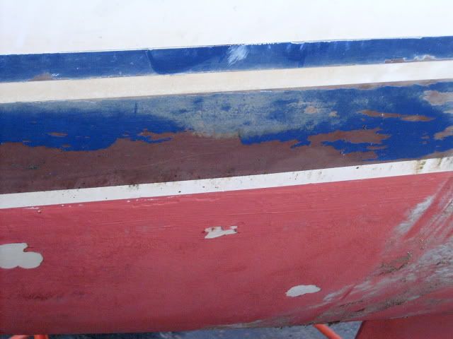

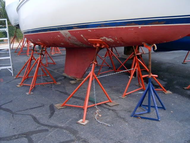

Folks - my new (old) 25 was hauled and power washed in my absence. First time down yesterday to cover for the great freeze.
Check out the bootstriping in the enclosed pics, guess I got some work to do. How bout I at least get rid of the white stripe between the bottom paint and first thick blue stripe. I'll paint it blue up to the highest white stripe (or all the way up and eliminate the small white ones in entirety?).
Guess I use paint remover vs. sanding where possible?
I'm trying to simplify...not beautify!

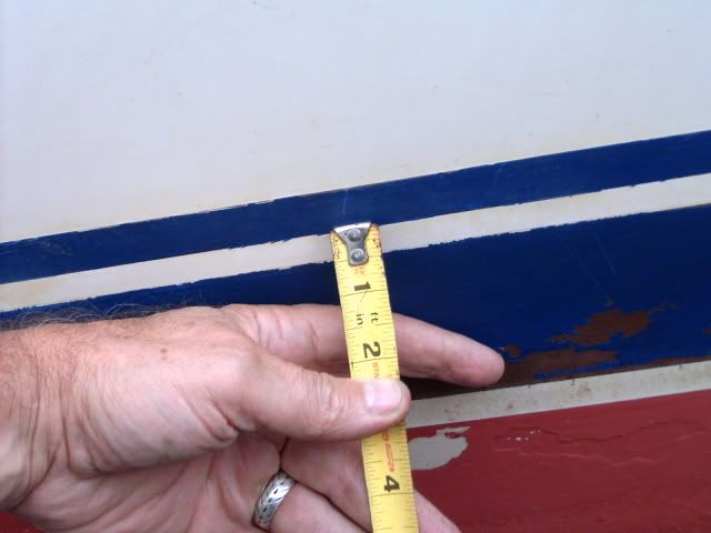

If I keep any of the small white ones, they look to be 1/2 inch. Whats the plan, put masking tape over them to paint adjacent stripes? Sounds tough to sand with masking tape on adjacent ones though!
HHEEELLLP!

Why do you want to cover up the white gelcoat?
If appears someone performed a color change on your boot stripe from red to blue. If it were my boat, I'd removed the failed blue paint covering the original stripe and then try to revive the original color. I'd only paint as a last resort.
Response Posted - 11/05/2008 :  08:02:10  Show Profile
It's always hard to tell from photos, but it looks like a previous owner repainted the stripes with a paint not designed for that purpose, and the paint is peeling. It looks like the white is the original gelcoat.
If so, I'd get some paint stripper that is specifically designed for stripping paint off of fiberglass, and strip off the old paint. (You usually have to get it from the kind of specialty paint supplier that sells to auto body shops.) Interlux Paint Company also makes a suitable stripper, but it's more expensive. Then I'd mask the stripes with masking tape designed for use with marine topside paint. Then I'd repaint the stripes with a topside boat paint. (Awlgrip is good, and Interlux makes two types of topside paints - "Brightside" and "Perfection.") Preparation and painting with those paints is more time consuming than using some other paint, but, if you use them, it should look good for a decade or more. If you try to use some other paint, it'll probably become an annual job, because very few paints can stand up to the moisture, dirt and oil at the waterline of a boat.

My vote is with Don (although I don't know about yesterday )... The original stripes (red) are molded in--you can see light through them from inside the hull. Strip the blue off, compound the red, and then, if it looks fairly even, apply some Poly Glow, VertGlas, or PTFE polish. Paint should always be the last resort on fiberglass, for the precise reason we're looking at there.

The original boot top is brown. It's under the blue paint. I would remove the blue paint, polish the boot stripe. Carry the bottom paint up to the bottom of the boot stripe.
I would use a stripper specifically made to use with gelcoat. [url="http://www.dumondchemicals.com/html/peelaway.htm"]Peel Away[/url] is a good product if you have a lot of patience.

but, the top thin stripe (whatever you call it, blue covering brown, is molded into the hull, right? ....how do I get that white as in your pic?

Oops, I missed that detail. It looks like the thin blue stripe above the original boot stripe is brown molded into the gelcoat also, but it's hard to tell from here.
What year is you're boat?
The older boats had a cove stripe at the top of the hull also. That should also match the boot stripe.
Can you post a picture of the boat from a little further away?
The white in the picture I modified is only that bright because of the computer. You will will have to [url="http://www.shipstore.com/SS/HTML/MKT/MKT2032.html"]clean [/url]the hull and then polish it to get it to glow. It's a lot of work. I can copy you the link if you want a serious workout.

You can check the stripper labels at Home Dopey--some are OK on fiberglass, and others not. Or you can buy it at a marine store--the prices aren't that different, and you don't need more than a gallon for this.
Personally, I'd leave the bottom paint "waterline" where it is, with the white stripe to accent the boot stripe. But that's just me.

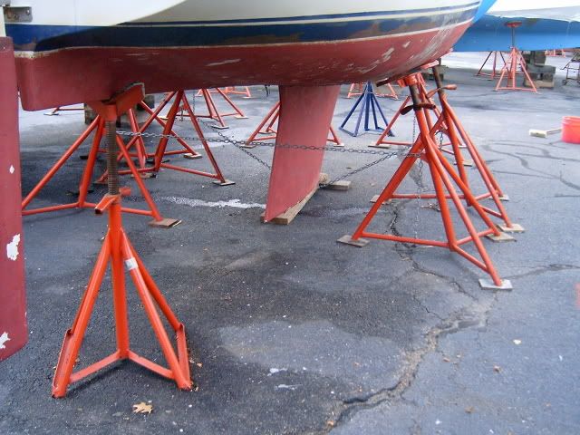

Heres more pics:

Hard to tell what's going on there. I would think that the upper thin stripe would continue along the transom if it was original. Maybe someone with an original 1983 can chime in here. Mine is a 77 and has only one wide boot stripe. It looks like your cove stripe was painted blue also.
When it comes to boot stripes, it's totally a personal choice. You can do anything you want. I always thought the reason for the boot stripe was to provide a place for the waterline scum to live without looking like a line of slime. Paint the car to look like dirt and it will always look clean. But, that isn't the case. It is strictly cosmetic.
I think the reason people are putting on the thin stripe is to make the boat appear longer and lower to the water. That's the impression I get when I look at Justin's boat.

My factory boot stripe on my '80 C25 consists of the same two stripes, small and large, exactly like that shown in the painted over pictures earlier in this thread..
