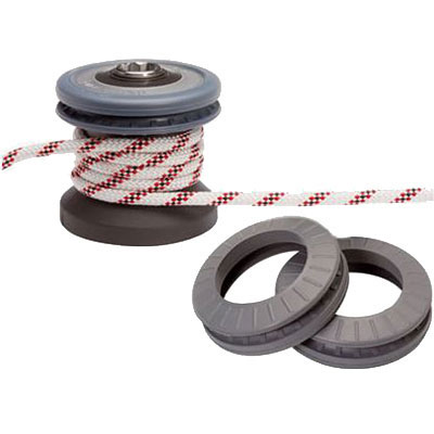

I purchased a pair of the blue winchers which go on top of the winches and claim to make them self tailing. Haven't figured out how to make those work like they should either. Gimmick or effective???

I use winchers on my Lewmar 7s for jib sheets. They are advertised as "self tailers", but they most definitely ARE NOT. In spite of that, that's not why I use them and I absolutely love them. I don't have anything but horn cleats, but the winchers allow me to "cleat" the sheet onto the winchers themselves, allowing them to be released quickly if necessary. And they always hold. I've never had one let loose on me.
I love them because they work for cleating easily with quick release available, and because I didn't have to drill into my boat and install additional hardware.

How are you loading up the winch with your winchers? I have the same onmine but haven't used them effectively yet. how many wraps are you putting on the winch? What is your technique?

For my winchers, I put three full wraps on starting from the bottom of the winch drum, then load the final wrap into the channel on the wincher starting from about the 3 or 4 o'clock position, then I snug the line all the way around inside the channel. Usually the line comes back out of the channell around the 1 or 2 o'clock position (where the bow is 12 o'clock and the stern 6 o'clock). I think with the winchers you need to have the drum full, thus the 3 wraps, for the winchers to work; because they rely on the final, top-most wrap to hold the line entering the wincher channel in the proper angle to maintain the hold. I'm sure the line width is also important. I think my jib sheet is 3/8th inch, but with my winchers I think I might be able to go a size down which I plan on doing someday.
A picture here would really be worth a thousand words; I hope my explaination makes sense.

I believe the issue with Winchers is that people inherit them and never see the instructions. I think that they way they are supposed to work is not intuitive, if I remember right the way they work is to wrap enough wraps until you are up against the bottom of the Wincher but it will usually only work for a couple of cranks and will need attention; and the inner track is for cleating, you do not grind with the line in the ring.
edit: "The simple operation works when the line is sheeted under load causing the coils to climb up the drum and are then gripped by the underside of the rubber body. When the sail is trimmed, cleating is achieved by locking the line into the ribbed groove."

Frank - that has been my expereince too. they only work for a couple turns at best then need attention which makes them worthless. Who can mess with an tangled mess while tacking under load?? not me! I am either doing something wrong or they are just another good idea. :o)
Response Posted - 06/08/2009 :  13:59:25  Show Profile
Frank - that is so right - I inherited my winchers and have never successfully sussed how to make them work...I get it now and will see if I can get any use of them this w/e. Thanks guys

I inherited my winchers, didn't like them at first, but only had horn cleats as an alternative. Not wanting to drill into fiberglass, I started playing with the winchers. Now, definitely like them, although a cam or V-cleat would be nice to have just for additional choices, but don't plan to add them any time soon.
'Tricks' I've learned, no more than two wraps before cleating off into the wincher, because line can get tangled otherwise if quickly released, which probably goes for any winch. I try to get at least a half a turn's worth of line into the wincher to make sure it holds.
Probably where folks go wrong, and where I would go wrong before learning via trial and error, is can't really pull on the sheet when it's in the wincher, it's better to unwrap, then sheet in. Additionally, can only tighten on the sheet an additional 1/3 turn or so once the line is in the wincher, via winch handle. If more adjustment is needed, need to take the line out of the wincher. This means unwraping it, sheeting in, then rewrapping it (unwrapping, rather than just popping it down being the key point). Some might not like them, but to each their own.
One nice benefit to winchers, is that that it provides another way to final trim the sheet. If not blowing real hard, I can just grab the top of the winch and turn a little. This is a quick way to sheet in a little, without having to use winch handle, or reposition to really pull on the line. And can look at the sail as you are doing it. This can be done even when it is too hard to sheet in by pulling. Just another trick to add in the bag.
I've never read any instructions, I'm curious to see what they say is the proper way.

<blockquote id="quote"><font size="1" face="Verdana, Arial, Helvetica" id="quote">quote:<hr height="1" noshade id="quote">WINCHERS:
A specially designed rubber moulding which fits over the top of standard winches converting them to self tailing. Easy to fit and available in four sizes to suit most winches. The simple operation works when the line is sheeted under load causing the coils to climb up the drum and are then gripped by the underside of the rubber body. When the sail is trimmed, cleating is achieved by locking the line into the ribbed groove.
According to the instructions for the use of winchers, the groove is used as a cleat. The actual self-tailing is suppose to be possible by the pressure caused by the underside of the wincher capturing the top coil. If you cleat it in the groove you will lose the self-tailing feature. That is assuming it works at all.
Response Posted - 06/11/2009 :  08:23:55  Show Profile
<br />...That is assuming it works at all.<hr height="1" noshade id="quote"></font id="quote"></blockquote id="quote">I bought some... They didn't--at all. My sheets were too thick.
