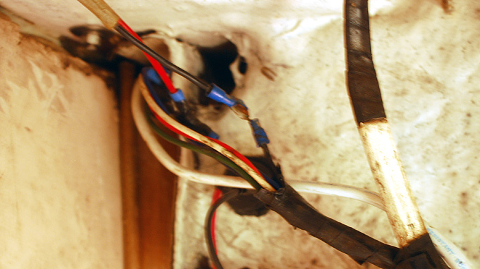

I turned on the cabin lights Thursday night and the running lights came on at the same time. I found the short last month (so I thought) wrapping the hot wire metalic tap that was exposed on the running light circuit. ( Pictured below red wires on the left with elect tape on the split )
I don't like the wire taps Catalina used ( although they lasted 25 years, so how can I whine ) as they have sharp edges, rust and are exposed, I whine.
I replaced one section of wire to the aft light, aft from where it comes out from the liner, to the panel, and plugged it into a fuse holder/switch that was unused and then found the fuse holder was broken. The back of my electrical panel looks like this now:
I added a fuse holder block on the right but I'm only using it as a grounding buss bar, the positive is not connected.
So... anyhoo... I've found an electrical supplier that probably has the fuse holders and switches, and I am going to change out the holders and run a new positive and ground wire to the front and back navigation lights. I'll inspect the hot/positive wire I remove and see if I can identify the location of the short.
The short is gone ( the two circuits no longer come on at the same time ) but I suspect the location of the short was simply pulled apart while I was working on the wiring harness, soon to return.
Pretty frustrating.

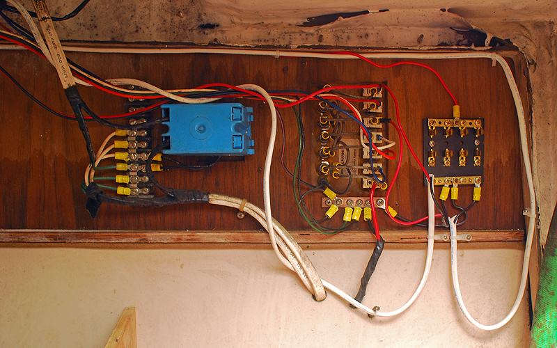

A fuse holder was broken, and the wire was so old it bothered me, so I rebuilt the electrical board, using the old switches and adding 5 new fuse holders.
Before:
After
Now I'm going wild thinking about adding lighted paddle switches ( Oh hold me back ), but I'm sure I'll come to my senses.
3477 Posts
Response Posted - 07/12/2010 :  06:17:11  Show Profile
I wired 16 guage in the panel, as the hot "buss" for the fuse holders had me connecting 2 wires per crimp and the blue crimps held the 2 lines of 16 well. Catalina had used 16 gauge. For the hot and ground wire to the front bow light I'm going to add I'll wire 14 gauge.
