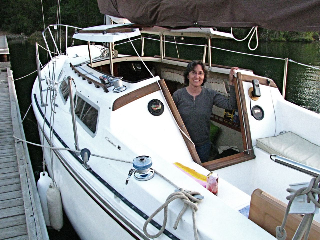

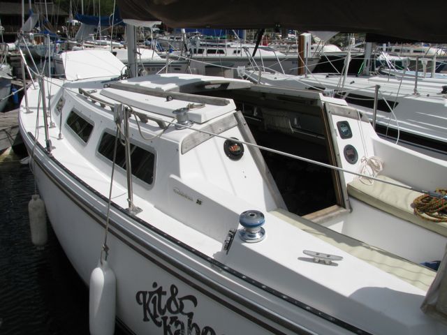

calden
194 Posts
Response Posted - 10/12/2010 :  14:40:09  Show Profile
Another before and after view using Cetol natural. Note that Cetol Natural does not have the same solids content. Practical Sailor noted that because of this it degraded a bit faster, being more susceptible to UV. However, it does not look as painted as what I had seen Cetol look like. Also, I am pretty far north and in freshwater, and don't deal with the relentless sun and salt conditions of, say, Florida. When I read about the Cetol Natural I decided to try it. I did not use a teak cleaner, which would have made it even brighter, but I did oil the wood well.
Before:
After: - not the best shot, but you can see a bit of the gloss on the companionway trim at the bottom.
