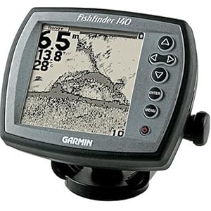

This is what I've decided on, which is economical and with good reviews.
http://www.amazon.com/Garmin-Fishfinder-4-7-Inch-Dual-Beam-Transducer/dp/B000ES8AWI/ref=sr_1_1?ie=UTF8&qid=1290117313&sr=8-1
Response Posted - 11/18/2010 :  17:14:08  Show Profile
Looks big enough for you sailboat, and not too big for the kayak. I did not see a photo of the transducer, do you know how it mounts? What's your plan to power it? Might be able to use emergency lighting sealed gel cells.

Response Posted - 11/19/2010 :  07:04:25  Show Profile
Bruce, there is an accessory kit that includes a suction cup mount adapter that, believe it or not, gets really good reviews. I know, a suction cup that actually works?!!? But this one reportedly sticks very well. The kit also includes a case that has a battery pack that takes 8 D batteries. I don't have any reviews on that, but I'm hopeful. If the case and D batteries don't work too well, I'll probably just rig something like a battery from a child's toy car, such as this one. I just hope I'm strong enough to wrestle the vehicle away from these two little girls; they look kinda tough.
