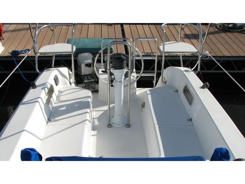

My boat has a Raymarine ST4000+ autopilot. As you can see in the above picture, its control panel is mounted in the starboard coaming, aft of the cubby hole storage. I would like to get behind it to install a SeaTalk cable to connect with my ST30 depth gauge which is on the forward bulkhead, where passengers often obscure my view. That way I can view the depth on the ST4000+, which is closer to the wheel. (This will also allow me to interface both with a chart plotter package that I am assembling.)
What is the best way to get back there? It looks like I have to remove the aft bulkhead behind the sleeping area, and try to get my (no longer skinny) body back in the lazarette area far enough to reach around and up behind the LPG locker. Hopefully the optional cover is not installed over the back of the ST4000, so I can feel my way to the SeaTalk receptacle and plug in the cable. Otherwise I'll have to remove the thumb nuts (hopefully without dropping and losing them) and pull the control panel forward into the cockpit to access the back.
My question for those of you who may have hunted around back there before is whether I'm missing some easier way to access it. For instance, is it possible to remove the LPG equipment, pull out the liner from that locker, and get up behind the coaming by reaching up behind the locker? Right now I have a sawhorse sitting on the locker to support the dropped mast, so I can't even open the locker to look inside.

You can't access the area from the LPG locker, the only way I know of is as you described, removing the bulkhead aft of the aft bunk.

It'll be reasonably easy to get to after you remove the aft-bulkhead as Steve said. It's not a painful process, just a bit tedious. A battery powered drill with a #2 Phillips's head will speed the process. It's easier if you remove the mattresses, but you can just slide them forward six inches or so, and you'll have room to work.

Thanks for the advice. I am less worried about taking the bulkhead off than I am about contorting my body to reach up behind the coaming. Fortunately, all upholstery was removed from the boat prior to haulout, so the mattress will not be a problem. The battery was removed also, so that's out of the way.
However, removing the bulkhead does have a few issues. First, it looks like I need to remove the small port bulkhead that forms a small storage area on the port side of the berth. Is that correct? That looks very straightforward.
Perhaps less straightforward is the fact that my 120v shore power panel and charger are both mounted on the starboard side of the aft bulkhead. I need to check how much slack there is in the wiring, but there's a good chance I'll have to disconnect all the wires to get the bulkhead out far enough to get back into the aft area. If there's enough slack then maybe it will be easier.
Have any of you actually reached back there? It must be reachable, since the original installer had to do it. From everything I can tell, the boat was originally delivered with tiller steering (that's why there are compass and depth on the cabin bulkhead) and the wheel and autopilot were retrofitted about 2 years after original purchase (since the ST4000+ manual has a 2000 copyright date).

I had an Autopilot in the same spot. I have removed mine but the process you describe to get back there is right. Yes, there are contortions involved but they are do-able. It is easiest to remove the unit and then do your cabling. There are a lot of connection points on that control head and it is tough to get the right one, especially if the one you want is on the top.
After removing the aft bulkhead a few times I decided to cut it on the port side of the battery door. Now I don't mess with my electrical panels or the port storage area when I need to get back there. I just remove the starboard side. Easy project to do.
