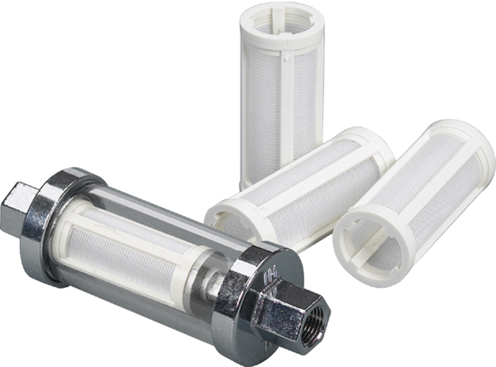

I keep a Moeller Clear View Inline Fuel filter on both of my outboards (15 hp on C250 and 50 hp on Trophy 15). Although the filter has helped keep junk from clogging the float valve on the 50 hp, its greatest benefit has been in diagnosing air leaks in the fuel system, which always pop up every few years. I swear by them, even though most motor manufacturers recommend against them.
