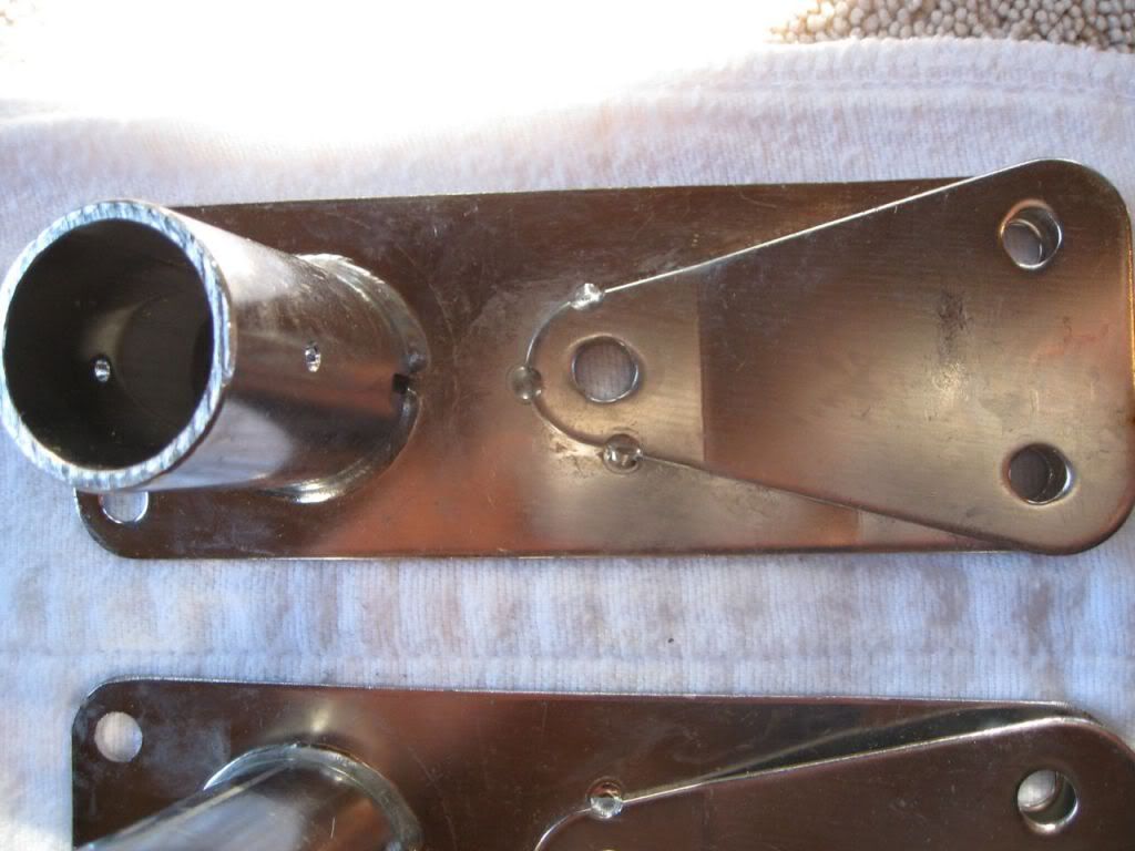

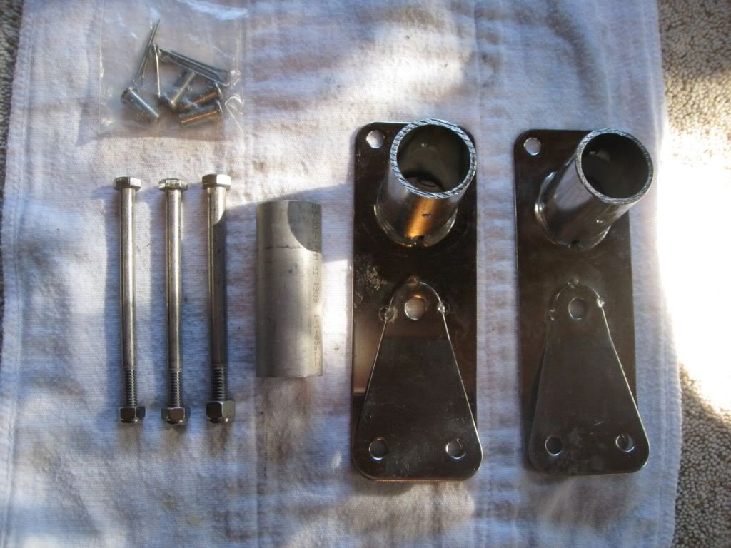

I have a new spreader bracket kit I'm willing to sell. Has all the parts, no instructions (but it's not rocket science). If you're interested make an offer... If nothing else maybe these pics will help you if you try to make your own.

I would deal with the wood first, then the spreader brackets. Make Ryan L an offer. Unless the masthead sheaves are showing damage or the wire halyards have meathooks, I wouldn't worry about converting the halyards.
