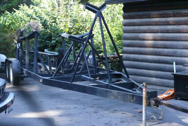

ok... I called the guy to ask bit more about the trailer.
I've asked him about the axles and given boats displacement 4550, he recommended to add another 1000lbs for misc equipment and trailer itself will be between 850lbs to 1000 lbs tandem 3500lbs axles are sufficient.
Below are couple of pics that i got from him as a sample. The only difference would be adding bow stop - which after all he agreed to do it at no extra charge.
The trailer seems to be quite solid and well made. What do you guys think.

<br />The trailer seems to be quite solid and well made. What do you guys think.<hr height="1" noshade id="quote"></font id="quote"></blockquote id="quote">
I think you should listen to a member's practical experience regarding axle ratings.
That trailer looks a little spartan as far as reinforcement and crossbars go. I'm not a trailer engineer by any means....it just looks a little....weak.
Response Posted - 08/23/2012 :  11:10:48  Show Profile
Kind of hard to say much from a photo. Channel dimensions, wall thickness, and cross member number and location are all important in trailer strength. Mass <u>looks</u> stronger than a well engineered product. I'm not saying yes or no, but my pretty well cared for, 40 y/o trailer is still sturdy. I have surge brakes on one axle, and my reading suggests that our loads are in a crossover range before electric brakes on multiple axles are clearly beneficial. The CG is high and over the axles, so physics says that the vast majority of the braking load will be transferred to the tow vehicle. The trailer brakes help keep the load behind you as long as the wheels don't lock. The high CG of a fin might be a nudge in the electric direction, I don't know. A friend has comfortably towed his powerboat of about the same weight with a 1500 for years; look at your "as equipped" towing capacity.

the outter frame will be made out of 2x6 tube steel and cross bars will be 2x4 tube steel. Tire will be 6 bolt, 15" class "D" (Larry recommended load range "E" - so not sure if I should ask him to upgrade the tires as well.)
any other comments thoughts (especially on the frame size).

I don't know who built my trailer, or even if it was built in 2000 (replaceable axles provide the only date), so I just wanted to show the extremes of custom trailers. The Trail-Rite uses half as much steel in my photo, and twice as much in yours. My custom job might either be overbuilt by someone who loves welding, someone who doesn't use engineering optimization methods, or was built extra stiff so it could use 15" tires and 3500# axles.
The other reason for sharing my photo is to help with what to order. I like the vertical keel posts to bounce the boat laterally straight before the keel lands on its own support pad. A keel support pad extended to the back of the trailer isn't needed. Mine is made of a c-channel pointed U with a wood spacer to rise the polypropylene skid well above any steel. I don't like the built in 10' extension and will be going strap-launch, even though it does work. The forward hull pad is a nice extra support. Last hull out I couldn't bow up as far as I would like, and hulled out with 1/4" space from the forward bow support. I know the center hull pad did something as I could rock the boat fore-aft and it would use this pad over the bow support. Forward of the bow support pad is missing another post holding a winch (reason I couldn't get the last 1/4" no matter how many dunks and pulls I did on the launch ramp).
Open frame trailers, like c-channels, do show everything from poorly penetrated welds to rust developing years later. The family jetski trailer is showing rust while rinsing the inside after 7 years of freshwater dips, with no easy fix. Powder coat is working well with just light surface rust in very few spots, except for where water collected under the keel support c-channel turned u-channel

6"x2" steel tube frame, 4"x2" steel tube cross bars and 5200 lbs axles seems like a lot of steel to me. Like i said earlier c channel vs tubes has pros/cons both ways.
The pic that I showed was just a sample that i got... one benefit of getting custom made is to listen to feedback on the forums, consult specialists and design something that is rated to pull weight of the boat and something that one is pleased and comfortable with.
