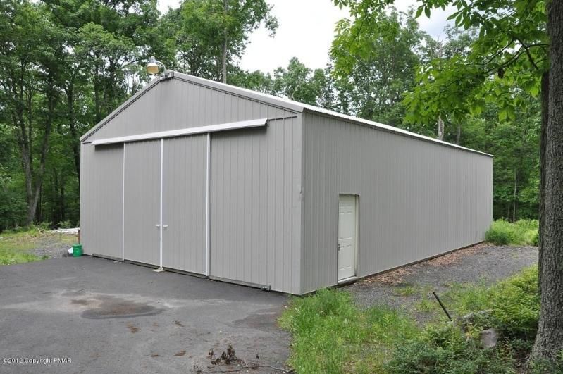

Well, in about 3 weeks I will be moving my boat indoors... We're moving and my hope is the boat/trailer will fit in our new metal building (crossing fingers it'll fit).

Response Posted - 11/07/2012 :  12:44:45  Show Profile  Visit shnool's Homepage
Here we are sliding the boat back into her winter cocoon... Very tight fit
No seriously VERY TIGHT!
Lots of room inside though, not a lot of head clearance though ;)
Well it'll be a couple weeks until I can focus on the boat again... In the meantime I have to decide on a color I want to paint the hull, and acquire all the sandpaper and VC17m I need, along with barrier coat. I'll be taking her down to gelcoat, fairing, and working my way back... I'll try to document the process.

Response Posted - 11/08/2012 :  18:52:40  Show Profile
I am so jealous. I'd love top have a shop like yours to store the boat and tinker around.
Response Posted - 11/08/2012 :  19:15:06  Show Profile  Visit shnool's Homepage
this was a long fought after home purchase, mostly for the 32 acres for our horses. lotsa work to do.
Response Posted - 11/08/2012 :  20:47:14  Show Profile
Congratulations! Looks like you won the battle!
