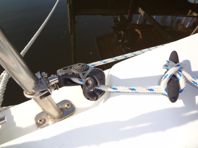

I use this Harken thing-a-ma-gigy:
Works very well, you only need to pull on the furling line slightly to get it to cleat.

Can you give me more info on this thingy. Bigger picture, link to buy etc.
My wife is tiny. When she tries to furl the jib she would like a method to temporarily hold the line while she goes for her next "bite".
Thanks.

I think it is this block:
[url="http://www.svendsensmarine.com/Harken_40mm_Carbo_Airblock_p/hk-2645.htm"]Harken Carbo Airblock[/url]
Attached to pulpit with this:
[url="http://www.westmarine.com/webapp/wcs/stores/servlet/ProductDisplay?catalogId=10001&storeId=11151&partNumber=339234&langId=-1&searchKeyword=339234"]Stanchion mount base[/url]

What you have is exactly what I have from another (cheaper) manufacturer - but without the stanchion mount. Mine is just shackled to the stanchion base..
We have only used it on one sail and found that the line would always cleat itself when trying to unfurl because the unit is not rigidly attached to the stanchion.
It was then almost impossible to uncleat because again, the unit is not rigidly attached to the stanchion.
Does the stanchion mount solve those issues?

<blockquote id="quote"><font size="1" face="Verdana, Arial, Helvetica" id="quote">quote:<hr height="1" noshade id="quote">We have only used it on one sail and found that the line would always cleat itself when trying to unfurl because the unit is not rigidly attached to the stanchion.<hr height="1" noshade id="quote"></font id="quote"></blockquote id="quote">
I have not had this problem, but I'm not sure if it is because of the mount. My experience has been that the line won't cleat until you pull it into the cam.
Here is a couple of better photos:
I only use the horn cleat when the boat is tied up at the dock so that it cannot unfurl unexpectedly.

In your setup, is the cam cleat essentially fixed in that position?

<blockquote id="quote"><font size="1" face="Verdana, Arial, Helvetica" id="quote">quote:<hr height="1" noshade id="quote">In your setup, is the cam cleat essentially fixed in that position?<hr height="1" noshade id="quote"></font id="quote"></blockquote id="quote">
The angle of the cam cleat, relative to the block, can be adjusted. However, you have to take the assembly apart. Once you set the angle, it's fixed. If I understand your question correctly.
