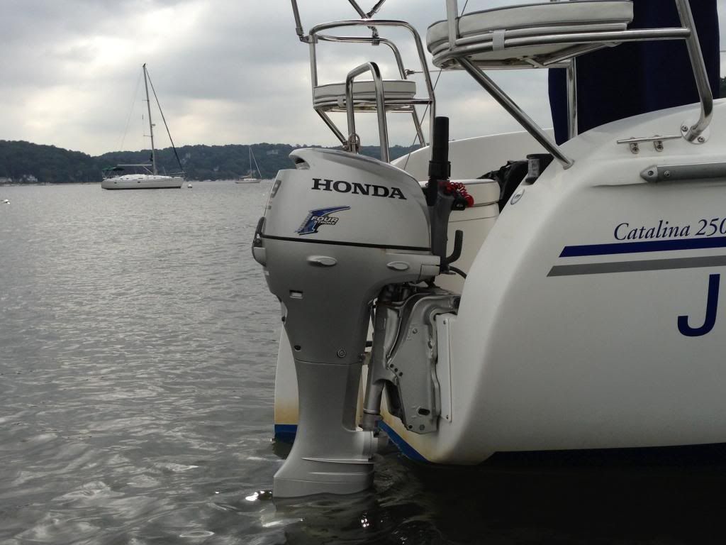

I have a 2008 250 Wing Keel with wheel and a Honda 9.9 extra long shaft with electric tilt mounted directly on the transom.
The first issue I have is that the prop sits just barely under the water and the water line is below the antiventilation plate. (I looked up what that was called in my owners manual)
The second problem is that even when fully lowered, the motor is tilted slightly forward and does not sit parallel to the transom. This causes the prop to thrust slightly downward and gives the appearance of something not being right.
I need a heavy duty bracket that will lower the engine 6+ inches and allow me to adjust the angle as well. It would also have to me easy to use with such an heavy engine. Any suggestions and/or advice would be greatly appreciated. Thank you.

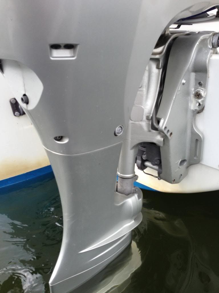

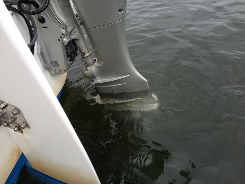

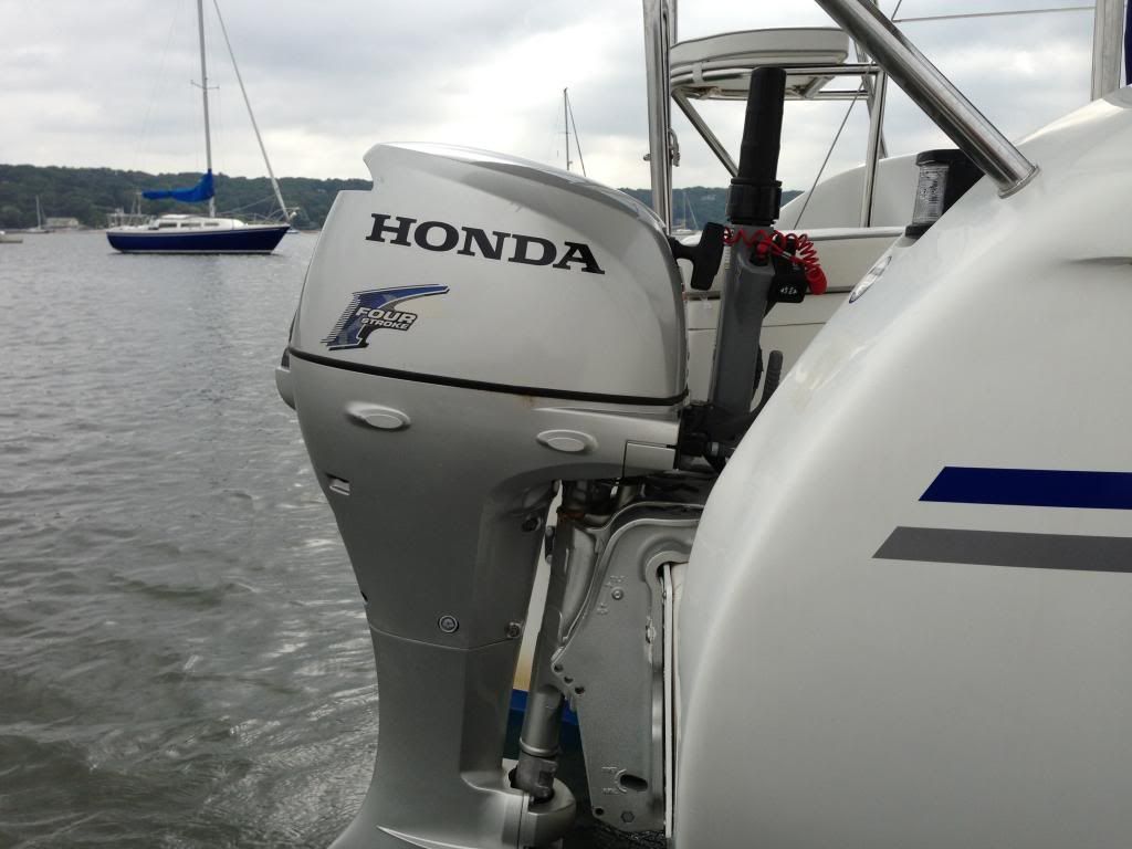

Response Posted - 08/31/2013 :  05:43:34  Show Profile
Thank you all for your help. Below are some pictures. The engine does match my paperwork - it is an extra long shaft. The angle adjustment pin was on the engine but I removed it for the pictures. Even with the pin removed I still have the angle down problem. The engine has power tilt and I suspect that is the reason for the angle issue. How does the depth of the prop look in these pictures?
Any help would be greatly appreciated. Thank you all again.
Response Posted - 08/31/2013 :  09:00:15  Show Profile
Something ain't right... Look closely at David's pictures, at the section of the lower unit just above the plate, with straight, vertical edges fore and aft. That is the "extension" that makes the outboard a Long or Extra-Long. His is probably 10" in height, making his lower unit 10" longer than the "short" model. The difference between the two extensions is 5", resulting in measurements from the clamp to the plate of 22.5" (L) or 27.5" (X?). The water might be distorting my view, but your extension appears to be shorter than David's. Your model numbers might say XL, but the actual hardware might just be L.
The tilt (vertical trim) issue is also puzzling. It almost looks like it's in a position for shallow water operation--see what your manual says about that. It could also be a problem with the power tilt. Note, however, that the bracket on David's transom is raked similarly to many power boat transoms, while the C-250 transom is essentially vertical. I can't tell from the picture, but David probably has the trim rod inserted in the holes that make his motor vertical. However, I haven't seen or heard of other owners with transom-mounted motors and your trim issue.

Response Posted - 08/31/2013 :  12:19:21  Show Profile
The problem is with the mounting.
The C250's transom is vertical. Most powerboat transom's are raked back something like 12 degrees. David's mount is vertical where it attaches to the transom but is raked back where the motor attaches.
Look at the angle srf2's motor is kicked out. Now visualize it being mounted so it's raked back the same as David's. To me it appears that srf2's motor would be vertical if it was mounted on a raked back mount.
If you look closely at some of srf2's close-up pictures there is a tab on the lower part of the motor swivel bracket that is down against the main bracket assembly preventing the motor from tucking any further up into the bracket. I assume this keeps the trim/tilt rods from bottoming out and being damaged.
Look's like the only way to remedy this issue is to mount the motor on a bracket or find some sort of wedge that would allow the motor to lean back when mounted to the transom.
I'd also recommend you put the tilt pin back in. The tab I referred to above appears to be a cast part and if you keep running the trim all the way in where that tab is constantly banging against the main bracket it could cause one or both tabs to snap off probably causing damage to the trim/tilt cylinders or rods.

Before I started adding things or buying brackets, I think I would contact Honda and send them the pictures. It appears to me that there is a problem with your power tilt. Assuming it is the same mechianizm as a 250 Honda, the tube should be parllel to the mounting plate when in the full down position, not angled away from the plate. IMHO
Response Posted - 08/31/2013 :  21:06:55  Show Profile
...and check that shaft length--regardless of trim, it appears to be too short.

Response Posted - 08/31/2013 :  21:31:32  Show Profile
The motor is trimmed in as far as it can go.
Notice the metal tab just below the 3 trim pin holes? It stops the motor from going in any further.
Also, notice up at the top of the brackets how they are flush with each other?
[/quote]
Response Posted - 08/31/2013 :  21:44:20  Show Profile
<br />...and check that shaft length--regardless of trim, it appears to be too short.
It's hard to tell, I think some of it might be an optical illusion but you may be right.
The bottom picture below has about the clearest view of the extension and lower anti-ventilation plates. Looking at the distance between the upper and lower seams of the extension it appears to me to be about the same as on David's motor.
Guess we won't know for sure until srf measures the extension. Either way his anti-ventilation plates sit much lower than mine does and I've only had a problem one time with ventilation.
BTW... you can also see the other metal tab stopping the motor from trimming in any further. If you look closely you will notice the transom bracket on David's motor is completely different than the bracket on srf's motor. I would assume the motor's are different year models.
