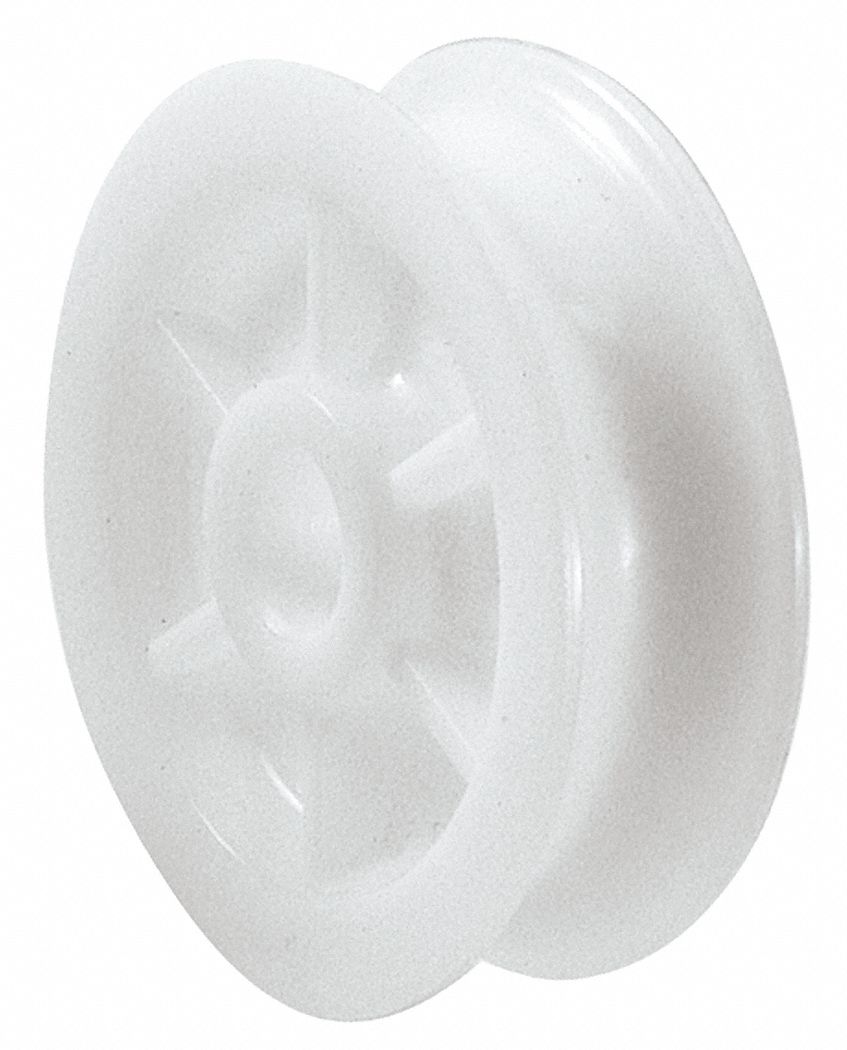

I use [url="http://www.grainger.com/Grainger/RONSTAN-Sheave-4FRW8?cm_sp=IO-_-IDP-_-BTM_BTB05209020&cm_vc=IDPBBZ2"]these from Grainger[/url] for the two. I use them for 1st reef and topping lift:
At the time I replaced my original sheaves a couple years ago, I was also having a hard time finding an exact replacement from all the normal sources (CD, WM, etc.). The Grainger ones (made by Ronstan) were the closest I could find to an exact match, and the price was good.
I think that my original sheaves were both the same width. But my owners manual calls for 5/16" Dacron on the topping lift. Many boats use smaller than this, and seem to be outfitted with narrower sheaves to match. At some point I will probably downsize my topping lift line, but plan to keep the same sheave.
As for the problem of jumping sheaves, the best thing you can do is make sure you have a good divider. My boat came with a grey plastic one that had chipped away over the years and was not performing its function, so I replaced it with a clear acrylic one that I made myself. This 3 year old pic shows the divider, alongside the original sheaves and original lines (which are thinner than my new topping lift line):

Response Posted - 09/29/2013 :  10:01:35  Show Profile  Visit britinusa's Homepage
That looks like a good solution to solve the lines jumping ship
