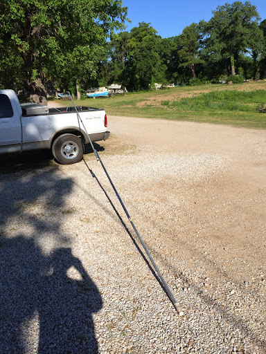

We had an interesting weekend. We were using the main halyard (stainless) to pull up a newly installed CDI Roller Furler on my friend, Tommy's boat. We looped it around the top of the furler so that when we were ready to disconnect it, we pulled a downhaul line which would unsnap the shacle and make it easy to pull back down. Well, that didn't work as planned. The twist that we had on the halyard prevented us from bringing the halyard and shackle back down. We were hooked right at the top of the roller furler. Each of us spent what seemed like FOREVER trying to whip the cable and see if we could get it to unwrap itself from the forestay. It seemed like we were going to have to disconnect the Furler and bring the whole setup back down and do it again! It was getting late so we decided to give up for the evening and try again the next morning.
I came up with an idea. I have a pool at home... I just happened to have two of those extra-long pool brush poles.... so, I put a hook at the top of one end, duct taped the two extra long poles together and slid it up the mast. In less than 30 seconds, I hooked the halyard and brough it down. It worked ! ! !
