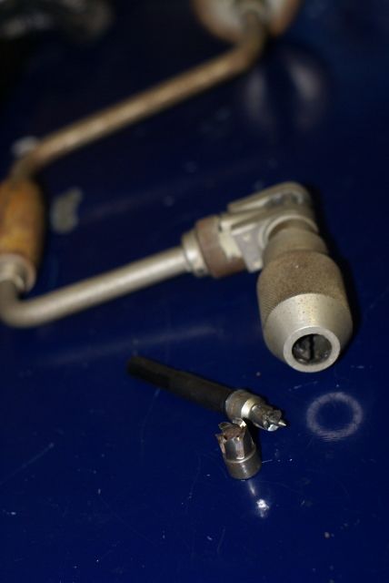

I use this bit with the ratchet brace to cut out bungs with very good luck. I think they are sold for electricians.

I am stopping just short of removing any wood with bungs but only because I haven't dealt with that before. I suppose now is a good a time as any to learn! Should I start on the exterior handrails? I'm guessing tap in new bungs, sand smooth and finish?

Yes. The teak eyebrows and the bridge threshold have bungs. The pieces are easy to remove once you get the bungs and screws out provided the PO didn't use 5200 to bed them in place.
