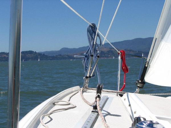

If you look at the photo below, you'll see that the (loose) jib furling line has already wrapped itself around the headstay.
Sigh.
Didn't notice that until in Racoon Straight (SF Bay) in modest winds (25+) and we went to furl the jib. Wouldn't move!
It's great fun to go forward in a good breeze with a nice chop to fix this. Hey, when lake sailing, this was never an issue!
Moral of the story - keep the roller furling line taught!!!

Response Posted - 09/03/2004 :  20:16:03  Show Profile
BTW, I can't really see (or imagine) what happened there. And I don't see how the furling line could wrap arount the forestay with my Hood furler. What happened?

Response Posted - 09/03/2004 :  23:19:27  Show Profile
Ah... it's harder to see on this version of the pix (down-res from the original), but the furler line is *not* leading up and into the spool properly. It's already wrapped around the furler... when I went to yank on it, part of the line snapped back onto the drum - slipping between the head of the drum and the metal tangs (right word?). In short, I had an unholy tangled mess that I had to fix while being tossed around and beat about the head by the flapping sail!
'twas quite fun, and *very* educational. The best lesson was that the wife and I have learned enough to be able to handle a situation like this without freaking out. That, and, of course, not to leave loose lines in choppy seas.

Response Posted - 09/04/2004 :  09:46:04  Show Profile
Kevin,
How much extra line do you have on your furler?
I don't have that much extra line on my furler and this seems to have reduced the possibility of fouling. When I first got my boat it had a ton of line on the furling drum and if I wasn't careful and paying close attention, this extra line would cause me problems. After shortening this line, when my sail is unfurled I have about 12 inches of tail on my furling line sticking out from the last fairlead in the cockpit and when the sail is furled there is only a few extra wraps remaining on the drum.
