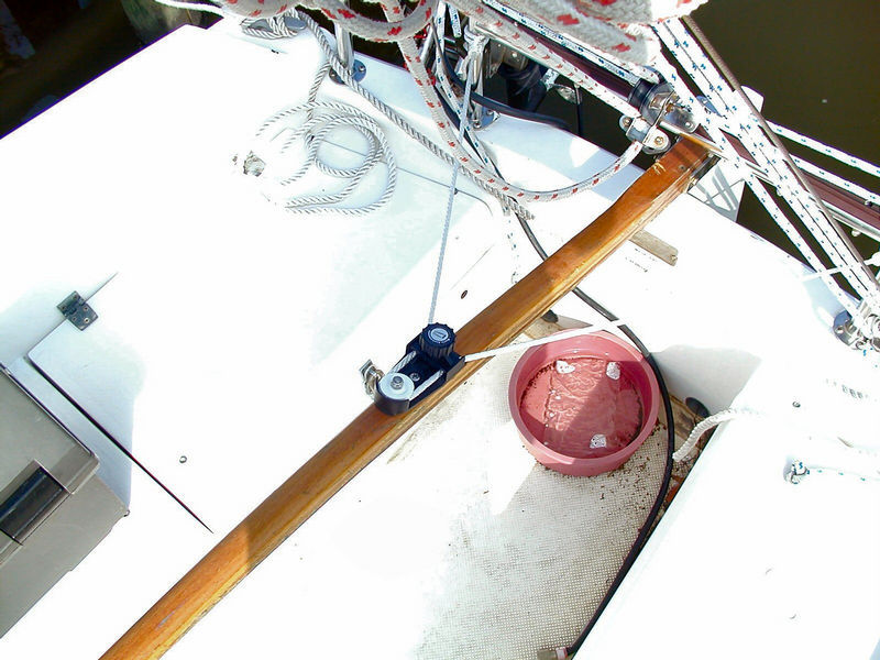

This may not work for you but the way I secure my tiller is the following:
I first slide on the tiller cover. Then I take the excess of the furling rig line (that's what's left after the furling line secured to a cleat on the port side just forward of the stern rail side stanchion) and holding the tiller amidships, I then wrap the line 3 times around the outside of the tiller cover toward the end of the tiller handle. Then I secure the line to a cleat on the starboard side just forward of my stern rail side stanchion.
This is how I leave my boat at the end of the day and also use same basic setup when I am leaving my marina and raising or lowering the main sail when single-handed sailing.
One of those tiller friction locks will work as well.
I do not have a real good photo to show what I am describing. The below photo shows the port cleat used to secure the furling rig line and you can make out the line then wrapped around the tiller. It then is secured to a cleat on the starboard side. When I leave my boat for the day, I secure the main sheet as shown i the photo - It's secured by one twist knot that is then hanging onto the end of the tiller...and when I put the 3 wraps around the tiller with the furling rig line, that's how I secure both the tiller and the main sheet loops.

Does anybody use a Tiller Tamer? I've been thinking about getting one . . .
Response Posted - 06/08/2009 :  05:43:13  Show Profile  Visit DaveR's Homepage
I have used a tiller tamer and liked it quite well, but had to replace my tiller and haven't reinstalled it because I bought a auto-tiller. As far as centering the tiller- I raise mine as far as I can and put a bungie around it and my double back stay, although you might need something more solid in a ripping current.

<font face="Comic Sans MS"><font size="2"></font id="size2"><font color="navy">Before you screw holes in your tiller and add a clunky piece of hardware to it you might try some of the less invasive ways of keeping the tiller in line. See the May Mainsheet Tech Tips.
Bungee or line wapped around the tiller and secured to the aft cleats.
If these methods don't work for you go ahead and buy the Tiller Tamer.</font id="navy"></font id="Comic Sans MS">
Response Posted - 06/09/2009 :  04:26:14  Show Profile
I use the tamer and run the lines through to the cam cleates that were used for the traveler. I've tied off my traveler in the middle. I didn't add any additional hardware, just the two screws on the tiller to mount it.
Response Posted - 06/09/2009 :  05:49:07  Show Profile  Visit DaveR's Homepage
Yeah, it's a very simple install. Also as AL suggested it's probably <i>the best</i> way to keep your tiller amidships at the dock or mooring.
