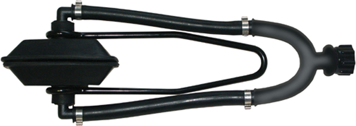

Does anybody have a 9.9 4 stroke Suzuki? The PO put a new one on right before he sold the boat 3 years ago and it's very nice but, one problem, there is no way to flush the engine after daily use. I sail in salt water and also own a Mako 22 with an Evinrude 175. The Evinrude has a flushing port that allows me to attach a hose with a quick disconnect to flush it out every time after use. There is an attachment for winterizing the Suzuki but that entails sealing off the water pickup which is under the cavitation plate and flushing water through the adaptor. While doing some research on this, there was a discussion on several web sites that basically said, new engines that are designed for saltwater don't need to be flushed after each use. Does this sound right? Like everybody else here, I sail a used boat and would rather maintain what I have instead of having to purchase something new because the original it wasn't properly cared for. Opinions?
Response Posted - 06/06/2011 :  14:14:40  Show Profile
<blockquote id="quote"><font size="1" face="Verdana, Arial, Helvetica" id="quote">quote:<hr height="1" noshade id="quote">but that entails sealing off the water pickup which is under the cavitation plate<hr height="1" noshade id="quote"></font id="quote"></blockquote id="quote">
I use this thingy:
But if your intake is below the cavit plate you might need this thingy:
Forgot to add; I have a Tohatsu and not a Suzuki.
Edited by - Davy J on 06/06/2011 14:18:09
keeldad
84 Posts
Response Posted - 06/08/2011 :  07:45:36  Show Profile
Thanks Davy J. The yellow thingy might be the ticket. I'll check the Tohatsu dealers. Vaguely I remember seeing something like that made for Suzuki's but I can't remember where I saw it.
