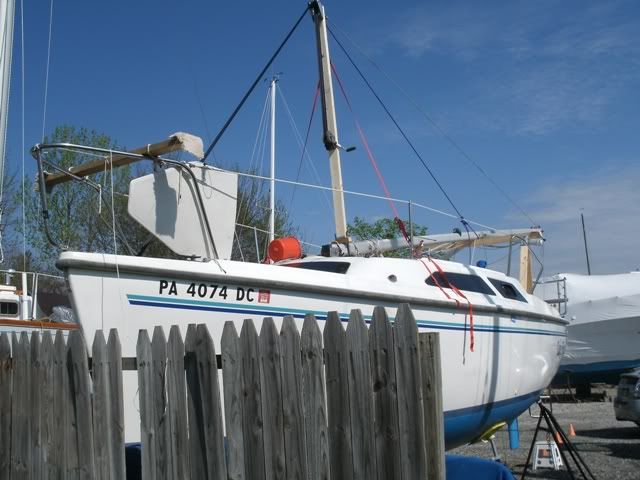

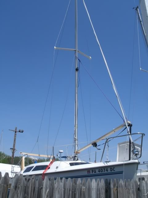

I do follow you. When the jib halyard approaches parallel to the mast, its force vector loses all of its vertical component. This is easily solved by a gin pole (if you have straps or stays to control sideways sway) or an A-frame (which provides both vertical vector and sideways control). THIS IS CRITICALLY IMPORTANT AND, IF DONE IMPROPERLY, CAN RESULT IN SEVERE INJURY OR DEATH. Be sure you understand the physics, or have someone who's done it before helping you.
Here's my setup, though the connection points are slightly different for the C25 than for my C250. (Sorry, this is a combination of lowering and raising pictures.) Note that I have TWO LINES holding the mast up. I wanted redundancy for this, so I used the jib halyard (as recommended by Catalina for early C250 models) and a harness arrangement below the spreaders (as recommended by Catalina for more recent models):
