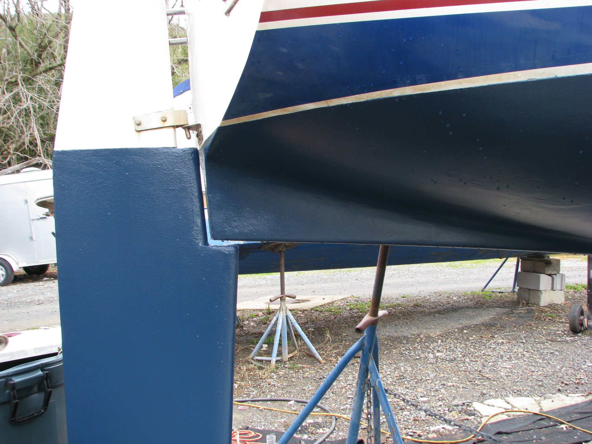

I missed the lower pintle issue but it appears to me there's a bolt missing in the port backstay chainplate just under the rubrail.
Response Posted - 03/04/2012 :  20:09:56  Show Profile  Visit OLarryR's Homepage
Don, it's not an optical illusion. The lower pintle is somewhat off but it's probably been that way for well before I bought the boat over 6 years ago. I have removed the rudder perhaps 2-3 times for one reason or another but mostly keep it in place since I sail year-round. I never noticed any issue removing/reinstalling or using it. I guess I am not going to mess with it unless I decide to get a new rudder...and I was going to replace it but right now I am leaning toward keeping it a little longer. Here is a better photo of what you observed:

GaryB - The "missing bolt" in port aft stay chainplate you spotted in one of my photos was on my mind this past week and so I checked it out this afternoon. Turns out the photo is not a closeup and therefore does not show enough detail of the chainplate. There is a bolt stud in the lower chainplate hole and that is clearly visible in the photo. The upper hole appears to be missing a similar bolt stud but having inspected it today, the upper hole actually has a large diameter phillips head machine screw installed flush with the chainplate and so looks like all is well !

<blockquote id="quote"><font size="1" face="Verdana, Arial, Helvetica" id="quote">quote:<hr height="1" noshade id="quote"><i>Originally posted by OLarryR</i>
<br />...The upper hole appears to be missing a similar bolt stud but having inspected it today, the upper hole actually has a large diameter phillips head machine screw installed flush with the chainplate and so looks like all is well!...
Doesn't sound like the correct application for a machine screw. Is the other side the same?

GaryB - WM sells machine screws with hex heads on them and Phillips Heads on them. I do not think I can easily check visually what's on the inside of the transom but I assume they both have similar hex nuts. Why they chose to use a phillips head through one hole and a hex head on the other is a mystery to me. Seems secure. Your boat have hex heads on both ?
Update: After this posting, I then searched the Cat 25 parts list and manual on this bulletin board but did they not provide enough detail of the transom chainplate. I then checked Catalina Direct and....apparently this was the design - One of the holes is countersunk in the chainplate to accept a phillips head that then sits flush on the chain plate.
I have a photo below from the Catalina Direct Website and here is a cut and paste quote that was with the photo:
"Note that one of the fastener holes are countersunk to accept a flat head bolt wher the chainplate is under the rubrail. Used on Catalina 25, 1985 and later, Catalina 27, and Catalina 30.
Some customers report they have only one bend in their 8" chainplate but this is the only 8" chainplate now available. For older 6" version see part #E1282 shown below."

Thanks for the update Larry. I didn't mean to be critical. Just seemed odd to have one bolt and one screw.
I'll have to check on how mine is setup.
