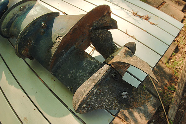

Apparently I thought the foot was gonna come apart cause I put some bondo on it sometime in the past...
Gee... think that will cause prop cavitation?
Response Posted - 04/17/2012 :  06:10:21  Show Profile
Looks like the gearcase oil is leaking a little, I had just changed the oil before I put it up and none was on the floor where I laid the engine, so its pretty much holding the oil. You can see some coming out the lower screw on the right.
The two big flat head screws you can see left and right are the lower unit filling plugs. With the engine upright you remove both plugs and let the oil run out, and then add gear grease by putting the tube of grease nipple in the lower opening, squeeze the tube till you see it come out the top, and then plug both holes.

Ok here it goes. This motor is extra long shaft evinrude 9.9. I believe it's 1985.
Anyways... Have a look a the pic:
This is the most excessive as it has been.
I've look at the thread that was pointed out earlier (about 1/3 down the page):
http://www.sschapterpsa.com/ramblings/Johnson_9.9_troubleshooting.htm
Apparently this might be caused by ruptured fuel pump diaphragm.
I had friend of mine that knows few things about outboards, help me take out the diaphragm and we checked it... it seems to be solid - no raptures or anything like that. We cleaned it all off, but after a week or so I started seeing the black sludge again. So at at this point I don't have a clue what it is? Could it be just gunk built up in the shaft???
The motor is running perfectly fine - that's what boggles my mind. I've never worked on outboards - but i can find my way in a garage - but I've been little hesitant to mess around with it myself as long as it's running. But now that i got new motor, I might play around with it. First thing is to get it fixed and to learn more about that motor - as i know they're work horses!
One thing that I learned end of last season. I've been using 100:1 fuel mix. As per manual and sticker on the motor. But apparently back in the 90s they realized that's not enough oil and changed it to 50:1. Not sure whether this might have anything to do with it - i guess unlikely.
Response Posted - 05/01/2012 :  08:19:57  Show Profile  Visit Prospector's Homepage
Szymek, can you wipe it clean and take another photo in, say, 5 days?
Ours has a similar sludge leak but only from the exhaust ports. I wonder if teh leak is coming from further up teh shaft or if yours has found a second routing that ours is still looking for.
szymek
209 Posts
Response Posted - 05/01/2012 :  08:50:48  Show Profile
Prospector: motor is sitting in the garage right now. I had few issues with it over the last few years. It stalled on me couple times as I was coming into the marina (really sucks when you'er on your own) and sometimes when i throttle down too quickly it would just die on me and it would take me a while to get it going again - ok as long as I'm still out on the lake. But since I go single handed majority of the time, I've decided that I will invest in newer motor. I'm not sure what I will do with the Evinrude. I don't want to sell it for next to nothing and i don't want it to sit around for years and "rot" away.
Anyways... This started probably in 2010 season. I started seeing bit of sludge coming out of the little holes right above cavitation plate - looking at the manual i believe they're to relive back pressure. I've noticed that they were quite plugged with really thick gunk. So i took a pick and I picked out as much as I could and i blew it out with air compressor. Since then it started coming down quite a bit - now sludge. So I figured that that the sludge just built up over the years and now that i opened it up it started coming down. However, it hasn't stopped through entire last season. It gets worst after I motor quite a bit. So I'm not too sure what to do next.

I'd pull that lower unit off and take a look......
Response Posted - 05/01/2012 :  10:14:31  Show Profile
Looks like your lower foot is leaking at the junction where the foot bolts on... I really could not tell from one shot. IF so I'd look at dropping the foot and putting some liquid gasket on that junction, after I read the manual. I don't know.. I've never seen that before. Is it coming from the exhaust? You could drain the foot, clean it up and put some sodium fluorescein in the gear oil, put it back together and see if it leaks. Put a crappy light ( blacklight ) on it and if it glows you know it is coming from the foot.
OR ... Put it on Craigslist and let someone else figure it out.
