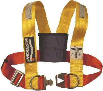

I am thinking of buying this harness from Defender (click picture for link). Comments?

Also, I was considering this tether. I want a double for getting around the mast, and I like that the attachment to the harness can be released under load:
<center>[url="http://www.defender.com/product.jsp?path=-1|135|88189&id=1685883"][/url]</center>
However, I have a major concern about using any of the tethers that I have seen. They all are about 6' length (this one is 2 meters). My boat has a beam of 8.5', or 4.25' from the centerline to the widest point. I believe that a 6' tether is too long, and would dangle me down in the water too much if I were to go overboard. I (in my infinite wisdom ) think a 4' length is more appropriate. I have not seen pre-made tethers this short. Also, when they're this short, elastic may not be necessary because, since it will not be long enough to dangle down on the deck. I am considering buying the snap fittings and making my own tether using either halyard/sheet line (I have some brand new 3/8" sheet that I could use) or flat webbing (which I'm going to have to buy anyway for the jackline).
What do you guys think of this? What is your experience with 6' tethers on a 25' boat?
Response Posted - 03/10/2013 :  17:28:55  Show Profile
<br /><blockquote id="quote"><font size="1" face="Verdana, Arial, Helvetica" id="quote">quote:<hr height="1" noshade id="quote"><i>Originally posted by TakeFive</i>
<br />What do you guys think of this? What is your experience with 6' tethers on a 25' boat?<hr height="1" noshade id="quote"></font id="quote"></blockquote id="quote">Depends on where you clip in. If you're clipped to the mast 3' above the <i>deck</i> level (not the coachroof), the line to the rail is 5' long. (...if I remember correctly from 5th grade.) That suggests your feet could get wet... (?)
Not sure where/how I would clip onto the mast. I was going to follow advice here and attach a jackline at the bow mast, and stern. I will of course do everything to avoid going forward, but if I am forced to (jammed furler, mainsail refuses to drop, etc.), I would clip to the jack line in the cockpit and probably crawl forward to the mast, then attach 2nd tether forward of mast and detach first tether. In this scenario, my most likely way of falling overboard would be sliding under the lifeline, and the jackline would likely be pulled a foot or so toward the side, no matter how tight it is. So I'm looking at 3 feet from the jackline to the side, and so the tether dangles 3 feed down to the water.
Somehow I think a 4' tether would be better. If I wanted to stand up, the jackline would lift from the deck by about 6" or so, and only has to reach to my upper chest for the tether. But I suspect I would avoid standing up unless I had to reach up the mast or mainsail.
I have ZERO experience with this, so I'll welcome your guidance. But I just wonder if these tethers are designed for more typical offshore cruisers in the 34-42 foot range, with a much wider beam.

I agree that 6' is pretty long for an 8' beam. Making your own would cost you the indicator stitching; I think you would be better off having a sailmaker modify one if you want webbing. Good, stitched, core to core eye splices in double braid would probably be safer than stitching webbing. I remember some dual tethers that had a 6' leg and a 3' leg. That would be much better if you could find them. .

<br />I remember some dual tethers that had a 6' leg and a 3' leg. That would be much better if you could find them. .
<hr height="1" noshade id="quote"></font id="quote"></blockquote id="quote">Yes, I remember seeing those too, and had forgotten about them. Aha! I did a quick search and found some! Look at the Kong Double Retractable Tether at Defender. Defender has other brands, too. (Stearns and Wichard; perhaps others.) http://www.defender.com/product.jsp?path=-1|135|88189& id=1685883

That's the exact same tether that I linked in my original post. I did not realize that one leg of the tether was only 1m long. That would work better IMO. What I had in mind as an alternetive was just to tie polyester double-braid to the clips to make my own tether. However, there's obvious safety benefit to having stitiching designed to fail at a certain load, and the other engineering features. So I'll add this tether to my "wish list" that I plan to order as soon as Defender's warehouse sale starts.
